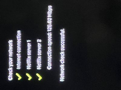

Anyway all SLK's tests we're fine and I just checked on Netflix as suggested and git the results below. I will check the Netflix speed next time it plays up as traffic is probably lower in the daytime.
the new system has been like this from day1, although not normally as bad as last night!  Initially were streaming through our previous sky broadband and assumed once the sky fibre was installed the problem would go away but sadly it hasn't.
The open reach guys put the box at the front of the house even though we said the living room and router was at the back of the house. The grumpy sky installer said he could only drill through to the other side of the wall to the OR box and moved our router to their and put a white booster box in the lounge. Maybe this just isn't working well enough?

@TaipansEmporium wrote:
126Mbps is more than enough for Sky Stream to function, but the signal needs to remain stable and fast. If it fluctuates or picks up interference from other devices then it can cause your puck to throw a wobbly and not function very well.
Stream pucks are quite sensitive to such things and needs as stable a connection as possible, either via WiFi or ethernet.
