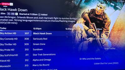

Unless I have completely lost plot and never noticed this before the midweek UI changes are in the tv guide too with the image on certain programmes now seeping into the listings.
Message posted on 08 Jun 2024 12:38 PM
Re: Ent OS 1.3
@IWTD wrote:Unless I have completely lost plot and never noticed this before the midweek UI changes are in the tv guide too with the image on certain programmes now seeping into the listings.
Pretty sure that change came with the software/OS update as I'm certain I saw it days before that settings UI change when my puck was upgraded.
Message posted on 08 Jun 2024 12:50 PM
Re: Ent OS 1.3
Only one of our pucks has been updated to 1.3, the others are still on 1.2 and it's there on them but also not as pronounced, this could also be a result of the actual TV's being more lower to mid range with nowhere near the hdr range as the main tv which is a high end one that the 1.3 update happens to be on.
Message posted on 08 Jun 2024 04:35 PM
Re: Ent OS 1.3
@IWTD am still on 1.2 and UI 20.284 and I get those images as well, so dont think its anything to do with the updates. Its the same as the settings boxes at the bottom being changed
Message posted on 09 Jun 2024 08:57 AM
Re: Ent OS 1.3
Only noticed the 'hero' page spread into the tv guide and other menu areas after the UI update change we had last week.
Was not part of the firmware Build version QS28 and Entertainment OS version 1.3 update that I had 29th May.
