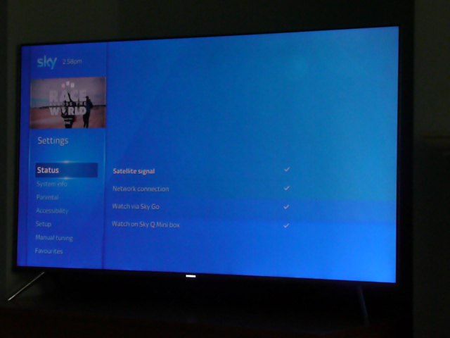

I have a Samsung TV with one connect box with the Sky Q box connected with Hdmi Cable.
Annoying horizontal band which moves down screen intermittently effecting the colours as it moves through picture.This only seems to be when when watching a Sky channel, but not if I switch to an app such as netflix, or my Amazon fire stick channels on different source input..
Seems strange as ony effects Sky channels.I have changed HDMI cables and turned everything of and reconnected but no change.
Any ideas or is it a specific issue with the Sky Q box.thanks

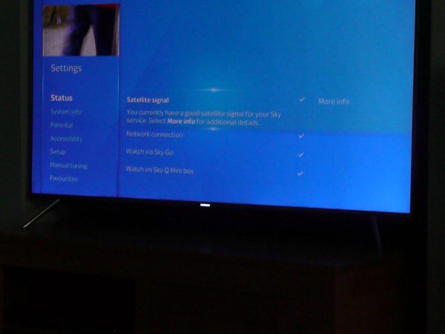

I have reset but still there,is fainter on netflix than on sky channels,but soes not happen if I switch source to the Amazon firestick which is also connected via the one connect box.Appears to be an issue between the sky q box and the samsung one connect box which is picking up some sort of interference to the picture.Are there any known problems on this type of connection set up?
Have tried switching the hdmi connections on the one connect box but no change.

I've had two different Samsung TV's each with a one connect box and never experienced that issue. To my eyes from the picture posted it looks like there is a fault with the sky box...

have just tested on another TV a JVC, which I can plug the hdmi leads for both sky q box and the amazon fire stick into direct. No interference on either source.Have re-connected to the Samsung through the one connect box and the interference band still showing moving through the bottom third of the screen. Have a call back from a Samsung tech. sometime in the next 24 hours so will update. Also was told each One Connect box is paired with the individual TV so cannot test another one connect box. Not sure this is true as cannot believe that they are paired one to one so that you cannot get another box if the one supplied with TV fails or has an issue?
