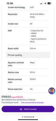

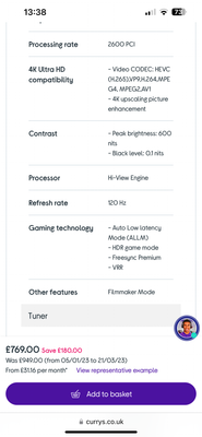

some of my tv specs
Message posted on 29 May 2023 01:41 PM
Re: UHD

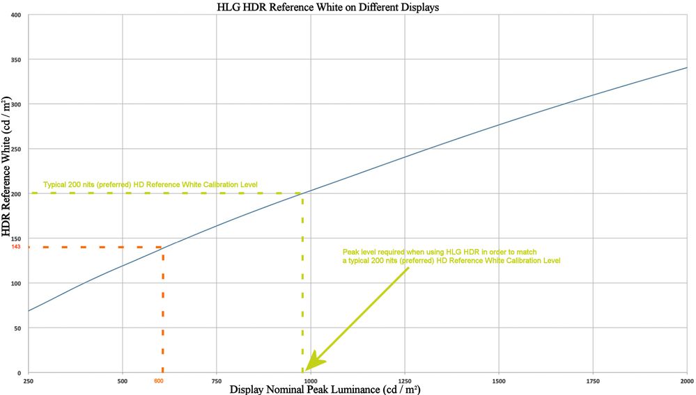

@Burntplumz If your new set can only achieve a peak level of around 600 nits, when attempting to display a HDR, HLG image it will be limited to achieving a nominal Reference White level around 143 nits.
But, I regularly find that quite a large proportion of people are using a nominal Reference White level of around 200 nits when they are viewing HD material, which makes them immediately aware of having a rather dim HDR, HLG image if their display screen cannot provide the peak luminance required to allow their HDR, HLG nominal Reference White level to match the nominal 200 nit Reference White level of their HD images.
So, my personal advice has always been to purchase a television that can achieve around at least 850 nits, if your preference is to have a relatively bright HD display image calibration, and it will not be having the benefit of the extended black levels available from OLED display panels.
Godfrey.
