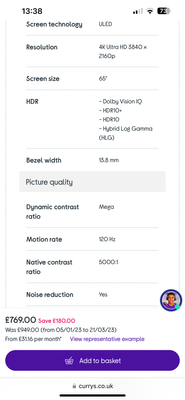

Do you know the exact model number? Normally if HDR looks dull or too dark it's because the TV can't reach the level of peak brightness required.

Even though £800 is a lot of money, for a 65 inch tv it is relatively cheap, so unfortunately you won't get a great experience watching HDR content. @Burntplumz

some of my tv specs

@Burntplumz   If your new set can only achieve a peak level of around 600 nits, when attempting to display a HDR, HLG image it will be limited to achieving a nominal Reference White level around 143 nits.
But, I regularly find that quite a large proportion of people are using a nominal Reference White level of around 200 nits when they are viewing HD material, which makes them immediately aware of having a rather dim HDR, HLG image if their display screen cannot provide the peak luminance required to allow their HDR, HLG nominal Reference  White level to match the nominal 200 nit Reference White level of their HD images.
So, my personal advice has always been to purchase a television that can achieve around at least 850 nits, if your preference is to have a relatively bright HD display image calibration, and it will not be having the benefit of the extended black levels available from OLED display panels.
