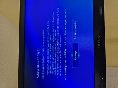

TV opens on Accessibility Screen.
When turning tv on it goes to an accessibility message, with the
options to go to settings or skip for now.  However, I can't get off this screen.  Have turned off at wall etc but still keeps coming up, so can't use that tv.

Re: TV opens on Accessibility Screen.
hi @Angela96
This message seems to have caused a bit of a quirk so try this:
Press & hold 4 & 6 on the remote to set to Infrared only
Hopefully you can then dismiss the message
Then try re-pairing in bluetooth mode with the box by pressing & holding 1 & 3 together
If this does not work try a full remote reset by pressing & holdng 7 & 9 until the red led above the SKY logo button flashes 4 times
Then try the 1&3 to re-pair & pair with the TV

This message was authored by: Angela96 Answer
Thank you  got it working at the point of pressing 1 & 3.  😃
