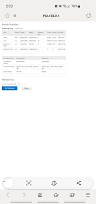

Message posted on 23 Apr 2023 02:24 PM
Re: Sky Q to games console
Message posted on 23 Apr 2023 02:26 PM
Does this mean it's only a 40mbs speed? They pay an awful lot of money for the broadband, I would have thought it would be better than what it is, the WiFi is slow even when in the same room as the hub

Message posted on 23 Apr 2023 02:36 PM - last edited: 23 Apr 2023 02:37 PM
@hAiRy+HiPpY+24 from what I can see it looks like you are on what used to be a 40/10 speed profile(this used to be an old broadband package) and is being limited to this by the high noise from my knowledge the noise has been inflated to keep you on the lower speed. What broadband package are you paying for ?
