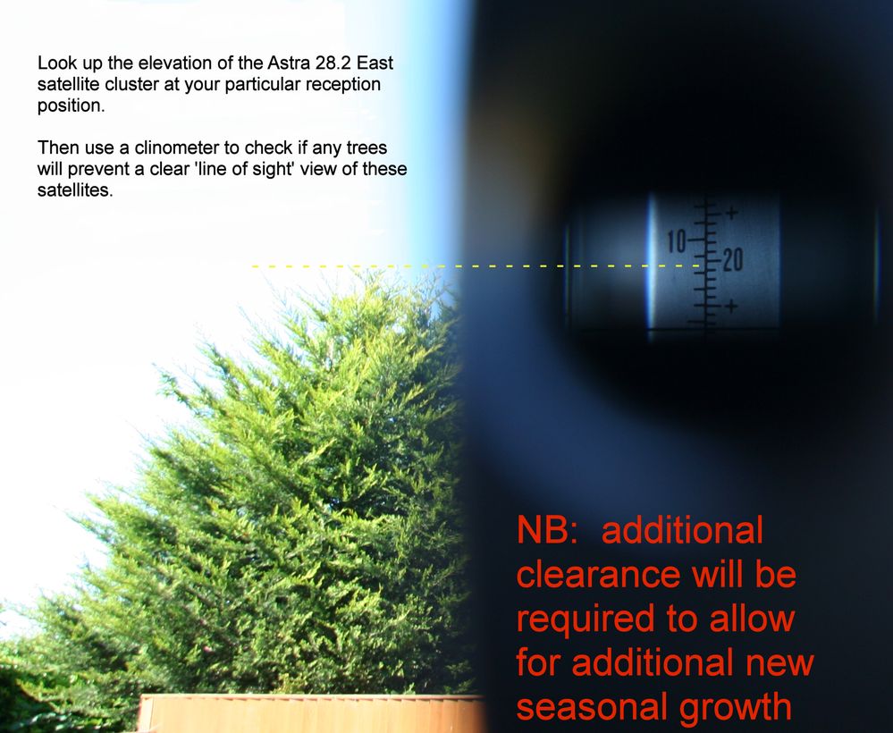

@Flipper444 Whilst an independent installer might well be able to install your satellite dish on a thicker, longer pole, in order to allow a 'line of sight' from your receiving dish to the Astra 28.2 East satellite cluster this season, bear in mind that healthy established tall trees can easily grow up to a metre in height every year, and the wind loading on a dish will not allow pole mounts to be very long if reception is to remain stable in high wind conditions. Additionally a long pole will certainly put quite a high load on this part of your wall in high wind conditions.
When I am installing where tall trees are involved I use dishpointer.com to establish the elevation for 'line of sight' to the satellites and then look through a clinometer in order to establish if that elevation is being blocked by the foliage.
