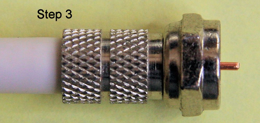

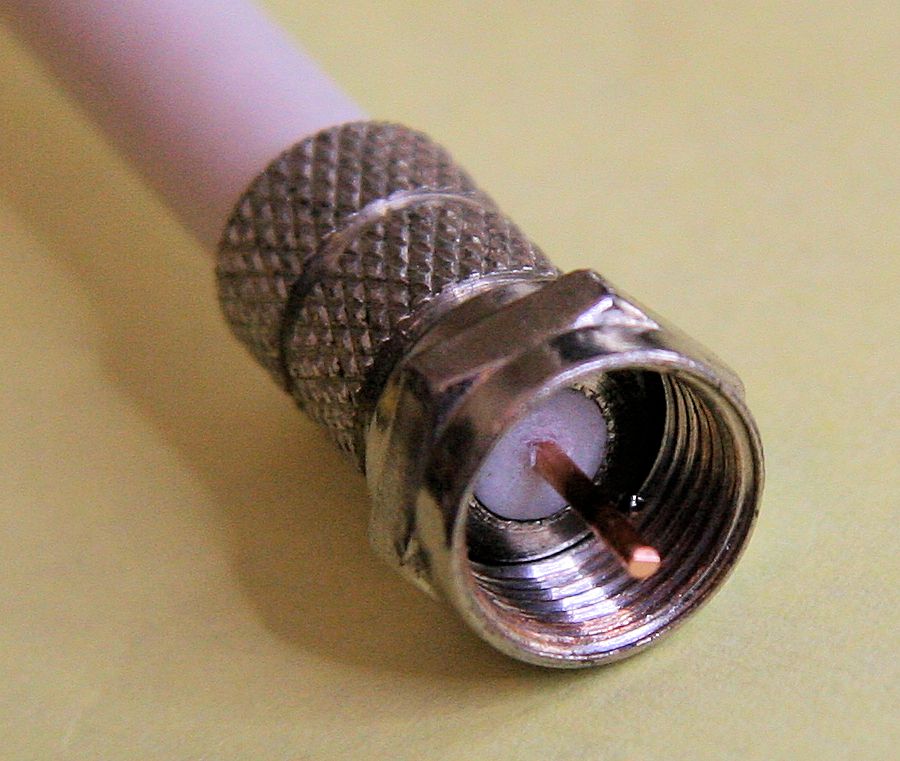

@monkeydust2 If this is the first time that you have fitted a 'screw on' F connector onto WF100 / CT100 coaxial cable, this is how I would prepare the coaxial cable.
Cable preperation: Fold back outer screen and tear off the inner foil
Then twist the F connector onto the prepared cable;
Finally, it should end up looking like this;
Godfrey
