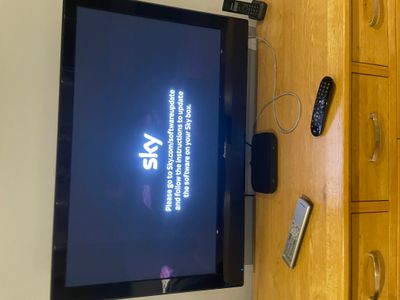

I'm referring to the Sky Q Mini, exactly the same problem I've read on many other customers on this forum. The sky controller in the bedroom is unresponsive, the box light is red and will not go green. The message on the screen relates to needing a software update, which I have done

As you can see from the photo, the message is generated by Sky

I'm unable to update the Sky mini, as the screen remains frozen, I'm unable to get to settings

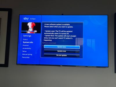

@Roger+Simonite wrote:
that looks the TV's own firmware prompt & not SKY Q - Try using the TV's own remote

So I've followed your instructions, after powering down for 30 sec, the Sky Q box did not reboot as normal. The previous photo came up, but the controls do no respond to selecting update now. Clearly this system is no longer functioning correctly, over to you !

@Roger+Simonite wrote:So I've followed your instructions, after powering down for 30 sec, the Sky Q box did not reboot as normal. The previous photo came up, but the controls do no respond to selecting update now. Clearly this system is no longer functioning correctly, over to you !
Try using your TV remote to control what is, obviously, a TV software update
