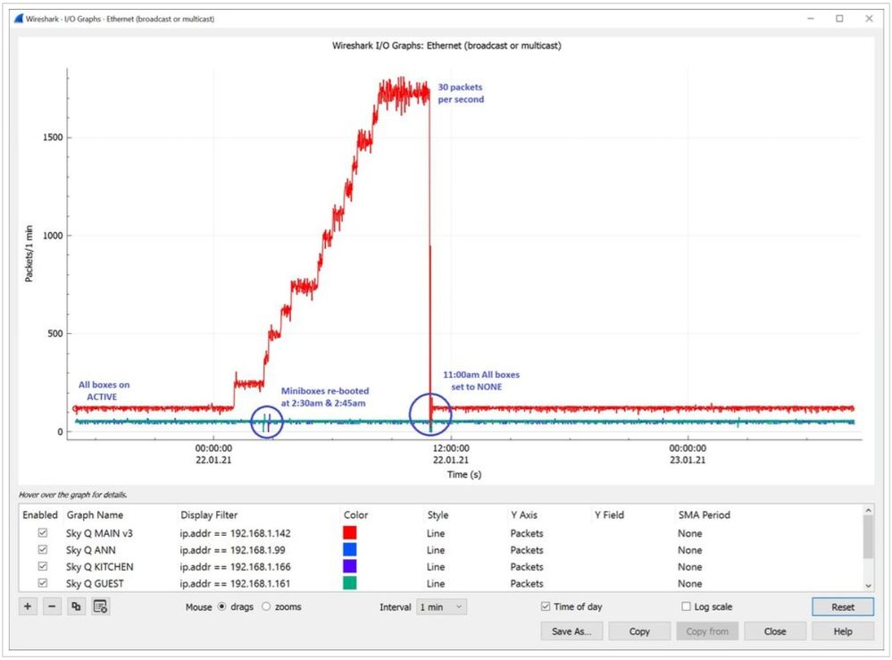

Yes, I remember. That was 4 years ago and caused by SSDP flooding the network and at the time only affected v3 boxes. The workaround at the time was to do the following:
The workaround to prevent the SSDP flooding DOS attack (only works if you have at least one minibox):
1. On at least one minibox, set Standby mode to NONE. You can do more than one if you want.
2. Make sure that this minibox is ALWAYS on - GREEN light. NEVER put this minibox into standby.
3. Power-off reboot the main Sky Q box.
I thought this had been fixed in a previous update - QR16? But maybe it's got introduced again in a more recent firmware.

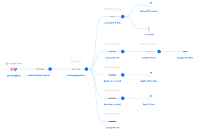

I somehow found a post somewhere about setting STP priority values for each of the UNIFI managed switches.
Start with the main/parent at 0.
Sub/child at 4096.
Next sub/child at 8192 (example below).
This seems to localise whatever tantrum the Sky boxes are throwing and the network is running well without any issues.
Hope this helps those on the UNIFI system.

Very interesting. Googling a bit, that should prevent network loops so maybe what's happening is the sky box is not generating all the traffic, but rather the switches keep rebroadcasting some advertising packets that the sky box first broadcast? With the priority set like that I think the higher numbered devices (lower tiers in the tree) don't get to do that, the root one is "in charge"

Yeah I know, but ... why? 🙂 it seems to me this could be a root cause. Switches spam network by forwarding broadcast advertising packets from Q indiscriminately. Does there need to be more than one network device to cause this? Who knows. Cheap switches perhaps just kind of get confused, wifi signals maybe go wrong tenporarily. Managed switches perhaps detect the loop as they have stp support and they block ports and seem to not work? I dunno. It really annoys me that we don't know what these boxes are doing, it's not documented, and maybe 30-40% of the posts on here are the same issues over and over. When someone has the kit and skills to do some proper diagnosis like this it's very useful.
