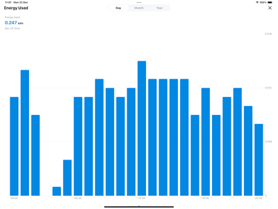

Here are some typical real figures (I watch a lot of recorded TV). Graphs produced by Tapo P110 smart plugs (need to wait for them to be approved).
November cost £1.71 , approximately 6p a day (you can see the Eco mode during the night).
