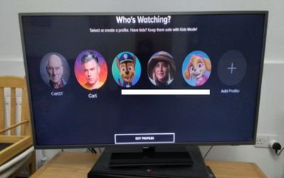

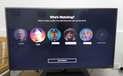

Kinda figured my explanation was accurate enough. 🤷‍♂️
It is happening on any programme on streaming services (Paramount, Disney, etc.) with shows that in anything other than 16:9 W/S.
Sometimes happens with the menus too.
So this...
becomes this...
