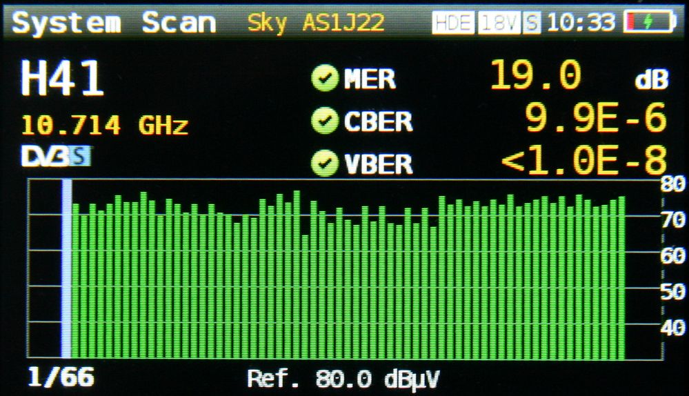

@TessleP82 A suitably qualified communal Integrated Reception System (IRS) installation engineer would initially check the signal levels and Modulation Error Ratio (MER) quality of everyone of the transponder signals that emerge from the LNB.
Then they would check these parameters on the 'Trunk' distribution cables that serve the central distribution cabinets on each floor, then the transponder signals that emerge from the multiswitches in each central distribution cabinet, and finally at the point where these signals emerge from the wall mounted media plate in your flat.
This is an illustration of a typical test meter scan of all the required transponder signals in order to confirm the signal levels and the requirement that the Modulation Error Ratio quality of each transponder is at least achieving a MER ratio in excess of 11 dB.
If your local company cannot do this type of basic test procedure, then you will require to employ a suitably qualified communal IRS 'System' engineer who can analyse exactly what component is faulty instead of throwing away everything in sight!
