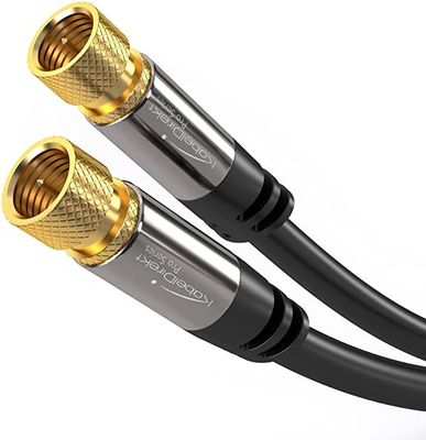

Looks like you might have disturbed the dish cables on the back of the Q Box.
Switch the Box off at the mains at check if the two cables are still secure and tight.
If they are loose carefully remove them by unscrewing and check that the central conductor in each is not bent or touching any part of the connector housing or cable screen.
The central conductor should be straight and protrude 1 - 3 mm from the outer end of the connector
