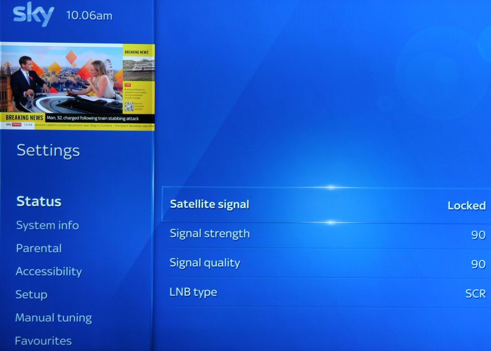

@Vlad154 Can you confirm that your Sky Q receiver is configured to use SCR LNB type.
What is your SCR signal strength and the default transponder signal quality reporting.

Last night when I get home I checked it and yes, sattelite signal was ticked as received. SCR was also ticked and it was saying that my signal strenght was at 80.

@Vlad154 Even a relatively poor quality default satellite transponder signal will achieve a displayed quality of 90 on a Sky Q receiver, so it is imperative that the Signal quality is shown as a steady 90.

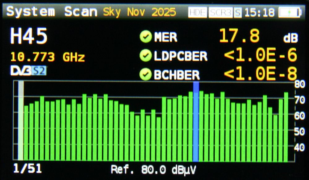

As I understand it, without actually sending a Multiple Development Unit (MDU) tained engineer to check the signal emerging from the communal distribution faceplate in your flat Sky can only remotely check the quality of reception for just the default Tp4 satellite transponder signal that you are receiving, and will have no way of remotely determining the quality of reception being achieved from the other 50 satellite transponder signals that you will require for error free Sky Q reception.
In situations where the communal management representatives claim to have checked that their communal distribution system has no faults Sky have always accepted that you will then require one of their MDU trained engineers to ascertain whether you have a problem with your present Sky Q receiver or a problem with the communal SCR signal that is emerging from your communal distribution faceplate in your flat.
So, I suggest that you inform Sky that you have followed their published initial procedure correctly and have reached the stage where you now require the attendance of a Sky MDU trained engineer to resolve this problem without further delay.
Any Sky MDU trained engineer will be able to replace your Sky Q receiver by their Televes H30 test meter and scan the performance of all the 51 required satellite transponder signals, whilst in SCR mode, to indisputably determine if you have a problem with your Sky Q receiver, or a problem with the quality of your communal Integrated Reception System installation emerging from the IRS distribution faceplate in your flat.
For example, this is a typical image of a communal SCR distribution signal that is achieving at least the required 11 dB Modulation Error Ratio (MER) quality on all the required satellite transponder signals.
