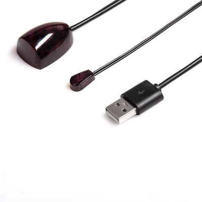

As you've unfortunately discovered, it's not really ideal to make such devices permanently inaccessible.
Per the comment by @oldfella, perhaps one thing to consider for the future is building in an IR extender.
As loaned hardware the Q box really needs to be removable anyway, as that's required for both replacement in the event of a fault and eventual return when the platform reaches end-of-life.
