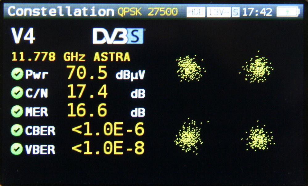

@NG16 Whilst you suggest that this problem predominantly occurs in the evening, when it is not possible to get a Sky engineer to attend, ask your Sky engineer to allow you to take a photograph of the Tp 4 transponder 'Constellation' display.
This will not only allow a check on uncorrected datastream errors (CBER) and the measured Modulation Error Rate (MER) which should comfortably exceed 11 dB, but it would graphically display the signal quality and any local interference that may be being encountered.
If your Sky engineer fails to resolve this unusual long term issue, it might be worth asking a local specialist engineer to repeat this short test for local interference during the evening period when you have been most likely to encounter this problem.
