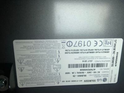

Message posted on 25 Feb 2024 04:00 PM
Re: Help with hdmi port
Message posted on 25 Feb 2024 04:47 PM
Ok it seems to have a component video input (should be 3 phono sockets labelled for red, green and blue pins)
Component inputs are only for video so it should also have two audio sockets (red and white) for the audio and it will be a maximum resolution of 1080i, almost certainly.
I think this should work, if you get a component video+audio cable with 5 plugs to go with it. They don't mention hdcp support but they kind of don't with these things.

@Chodley wrote:Ok it seems to have a component video input (should be 3 phono sockets labelled for red, green and blue pins)
Specs (https://www.manuals.co.uk/lg/55lb650v/specifications) seem to infer 3 HDMI's?
EDIT: Reading again, it seems all ports have 'fell in' perhaps
Interestingly, there's a SCART socket which can usually accept composite video (as opposed to component). Would be easy on a mini.
There seems plenty of 'cheap' HDMI to RCA converters - however, HDCP may be an issue as you note.

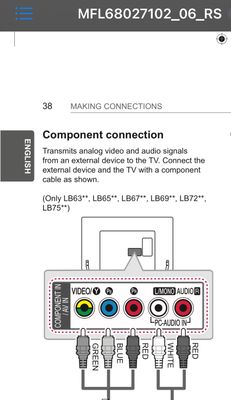

Message posted on 25 Feb 2024 07:48 PM
From the LG site, this is in the LB650V manual. I have no idea what these model number qualifiers mean though)
