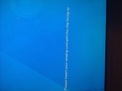

Discussion topic: Help needed? What do I do about this on screen message?
This message was authored by: Tinaneo
Re: Help needed? What do I do about this on screen message?
The image won't appear until moderated.
I'm guessing it's your TV generating the message rather than the Q box?
@Tinaneo wrote:
@Tinaneo try giving your card a clean then re-inserting it making sure it clicks into place
LG 49SJ 810 V UHD TV
Google Pixel 10 Pro XL mobile
Hi @Tinaneo
First check that your viewing card is correctly inserted.   Viewing card is in the right hand end of the box.
If it is in correctly there is not enough of it sticking out to grip and remove it.
Push it fully in and it will pop out slightly enough so you can remove it.
Make sure that it is in chip side up and chip end in first.   Push it gently fully in and you should feel a slight click when it is engaged.   If it has popped out enough to remove it is not located correctly.
If you are satisfied that it is in correctly
Try refreshing your Viewing card.
Home - Settings - System info.
Highlight Viewing card number and then select Setup on the right hand side.
Then select Use this option to trigger a callback
No call is actually made but the Viewing card should be refreshed.
Thank you, helpful information
