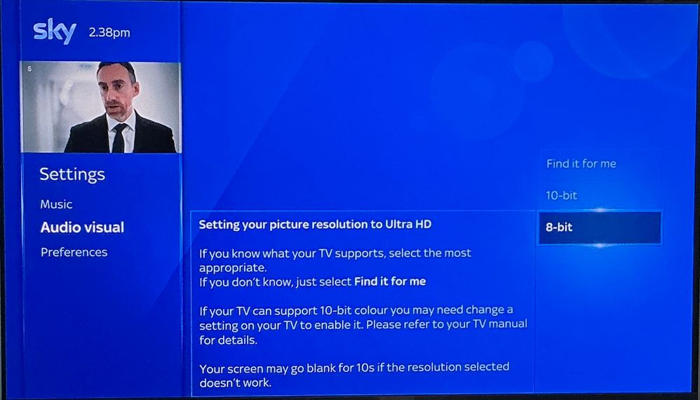

Hi @geordiejohn1950 Can you explain why you cannot set it to 8 bit. It should be a simple case of manually setting it to 8 bit. Do not use the Find it for me.

It just said I can't do it and took me to settings to put back to 10bit?

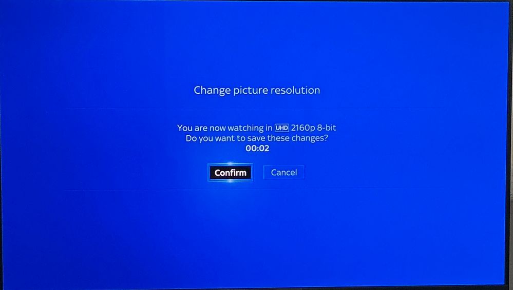

I did set 8bit but my tv took me back to settings and I had to put to 10bit,I will ring Sky tomorrow.

Did you hit confirm before it timed out?
