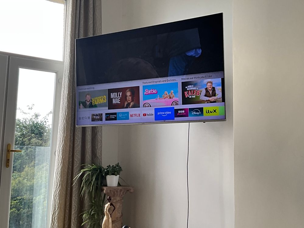

Screen does not support HDCP apparently,tried the small Qbox but nothing,there was 2 icons for sky but they've disappeared and I tried to download them but says error . Had theses qboxes for about 8 years not hardly used them. Any ideas appriciated

Hi @Sheldon419
First make sure that the Television is switched on and is switched to the HDMI input to which the Q box is connected.
Then with the Q box switched on with green led illuminated
Press
Home 1 0 8 0 Home
on the Q box remote control.
This will change the Q box to standard resolution which will work for all TV’s.

Thanks for that ,the only problem is the Sky Icon has disappeared for some reason

What is "the sky icon"? Something on your TV that auto-shows what it thinks is on the other end of an input cable? You should still be able to choose that hdmi input by cycling through them.

Yes just like Netflix and prime ,sky was there but I don't know how to get it back on the sky tv

Where's the HDMI cable? (I presume that's the power lead for the TV hanging down?)

With the TV turned on, disconnect then reconnect the HDMI cable from the Sky box. This will then trigger the HDMI handshake and the TV should detect the Sky box and add the Sky icon to the toolbar at the bottom of the screen.
I had the same issue with my Samsung TV a couple of years back.
