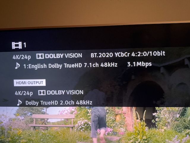

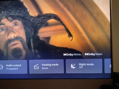

@82bit I use an Apple TV 4K with our Glass TV in the bedroom. Atmos content works fine from iTunes movie purchases, Disney+, Aople TV+ content etc. Taken to answer a different question last year, the following is from The Hobbit: An Unexpected Journey, bought on iTunes apnd playing back from Apple TV 4k:
Attaching my Sony X800M2 4K Blu-Ray player though and playing the same film back on disc, Atmos doesn't play - instead Glass has the player downmix the audio to 2 channel stereo:
If you're using Atmos from a streaming source (so Atmos via lossy Dolby Digital Plus), you're ok. As far as playing back Atmos from a 4K BluRay (so Atmos via lossless Dolby TrueHD). Not sure if this is true for all Atmos/Dolby True HD bluray players though.
With regards needint the Sky UDH/Atmos add on to play back Atmos via Apple TV 4K, I'm almost vertain you don't need it (always had the add-on here ourselves). Given Atmos can be played from Prime, Netflix 4K tier etc without needing the Sky UHD/Atmos add-on, you should be fine playing Atmos via Apple TV 4K without the add-on.
