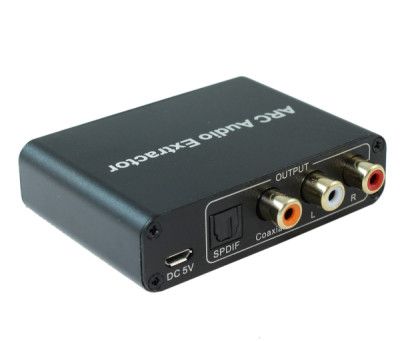

The 'solution' is for the user to acquire an eARC or ARC HDMI audio extractor with optical output (or, as you say, reject Glass and use a Stream puck with a non-Sky television that has optical audio)

I did, as suggested, purchased an eARC adapter and connected the adapter to Sky Glass via an hdmi cable. I then connected the eARC adapter to the hearing aid adapter via the toslink optical cable, but I'm sorry to say that it did not work, so I don't know what to try next. Any more suggestions to this problem please.

@Terry50 The Glass TV is pretty basic and is missing a number of common features.  I also have Oticon hearing aids but the basic model as unlike you do not need any additional equipment but I do appreciate  where you are coming from with your comments.
Seeing as the ARC adapter didn't work, I would be inclined to consider the other suggestion made by @TimmyBGood and return the Glass TV and replace it with a Smart TV and a Sky Stream puck.  This will give you the same Sky streaming functionality of Glass but with a better and more modern TV which will almost certainly have an optical connection (but check before purchasing).

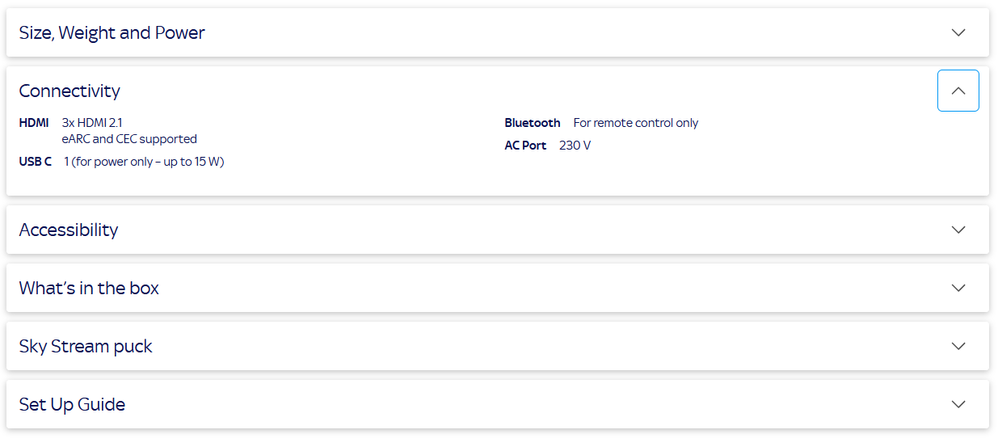

https://www.sky.com/glass/technical-specifications
Re: Using hearing aids with Sky glass
@GlennT1 wrote:
The sepcification is not clear
Unfortunately I'd suggest that's more of a user expectation issue: Sky never claimed Glass has optical audio output.
