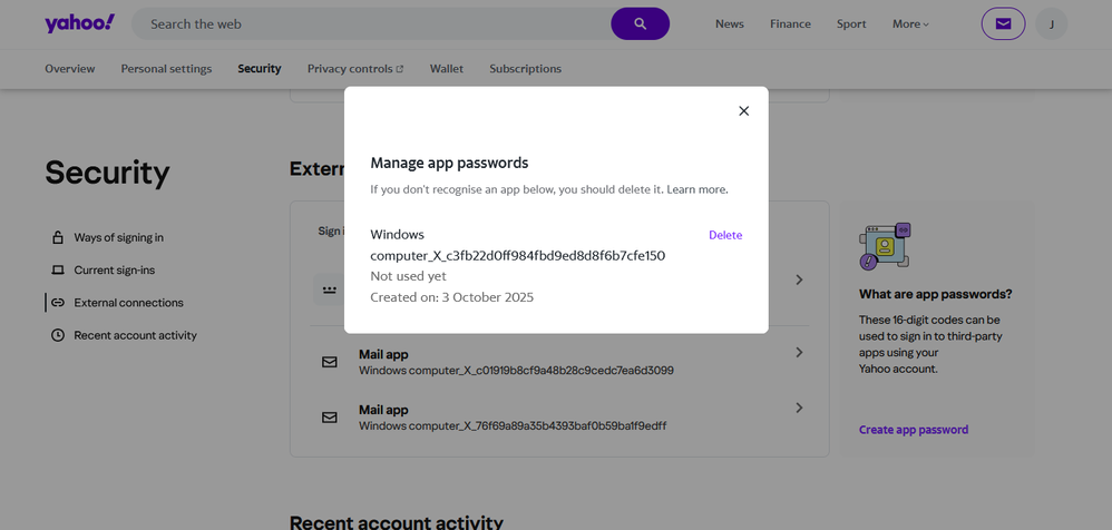

Message posted on 27 Nov 2025 08:33 PM
Re: Inbox e-mails after a short while are being transferred to "Delete" and then deleted
As Sky doesn't give us a way to manage our app passwords, try logging into Yahoo here, using your Sky credentials:
https://login.yahoo.com/myaccount/security/
And see if you can see anything suspicious. Scrolling down to "Recent account activity" should show if an app password was created recently.
If there is an app password created, and it wasn't by you, scroll back up to "External connections" and there is an option to delete them. I wasn't expecting it to work, but I deleted one, and now my Outlook login isn't working so it did work.
Do let us know what you find.

Message posted on 27 Nov 2025 08:57 PM
@Searcher9 wrote:Many thanks . That sounds great - altho not being able to use your Outlook login makes me very nervous !
How would I overcome the resultant possible/probable problem ?!
Just create a new generated password. https://www.sky.com/sky-yahoo-mail/manage-apps that's what I've done.
Do you use Outlook, and if so which one? Are you using generated passwords at all?
