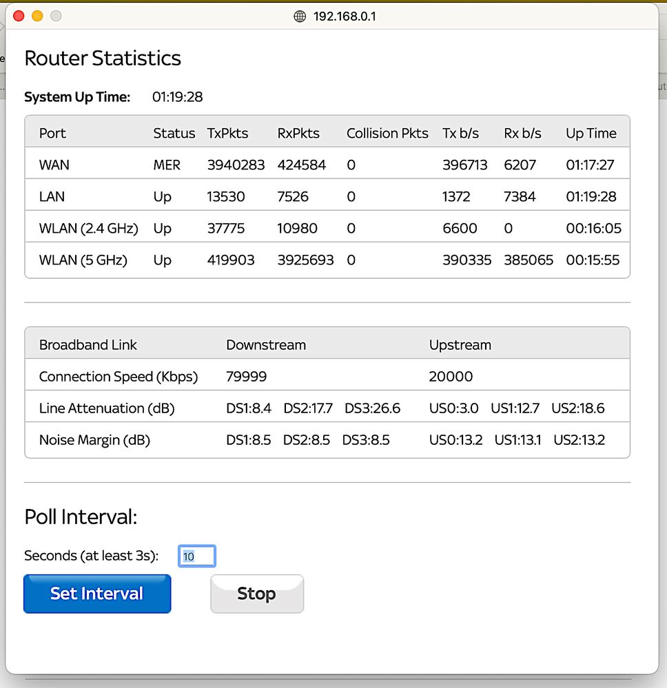

@Negativepitch42   Please can you post your router stats so the forum can advise on any issues. This link explains how to do that https://helpforum.sky.com/t5/Broadband/How-to-find-your-Sky-Broadband-router-stats/td-p/2855717#

Re: speed drop.
Sorry, forgot to use the reply to you.
See post above for images.

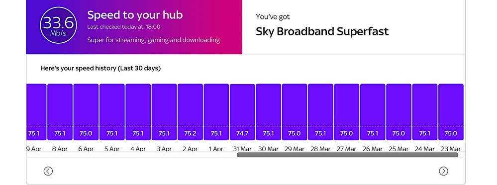

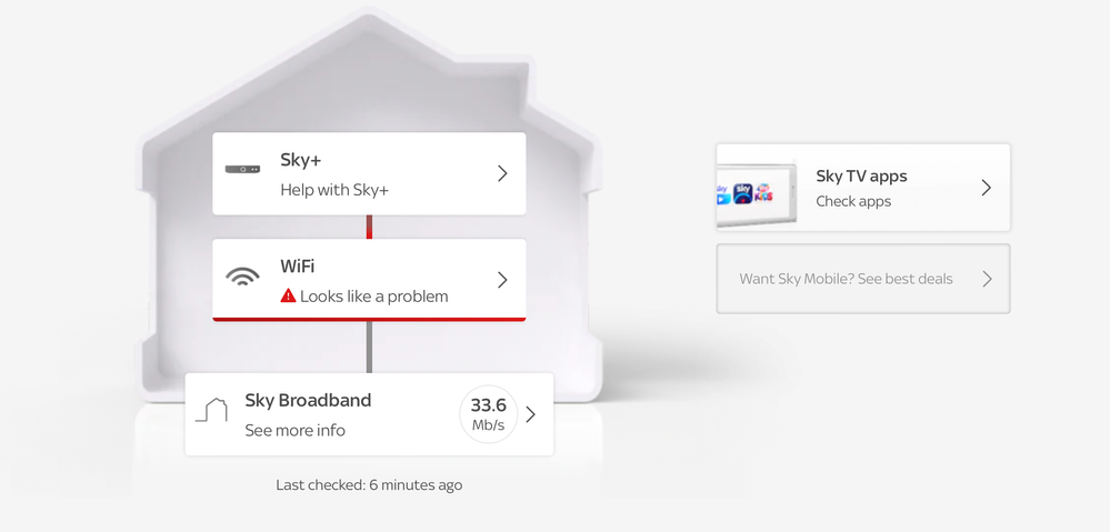

Just ran Sky's own test this morning... Hmmm...

It will be interesting to hear what the engineer has to say, must be difficult though if she has actually fixed it?! With the modems connecting at 80Mbps you would have thought it would work fine, but you have documented evidence it wasn't.
Re: speed drop.
@Negativepitch42 To me it looks like a faulty hub as your Wifi radios are resetting themselves.
