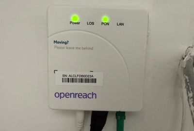

@leon-brown Take a picture off your ONT attach it using the camera icon and post it up!

Re: sky max hub red light, LAN no light
