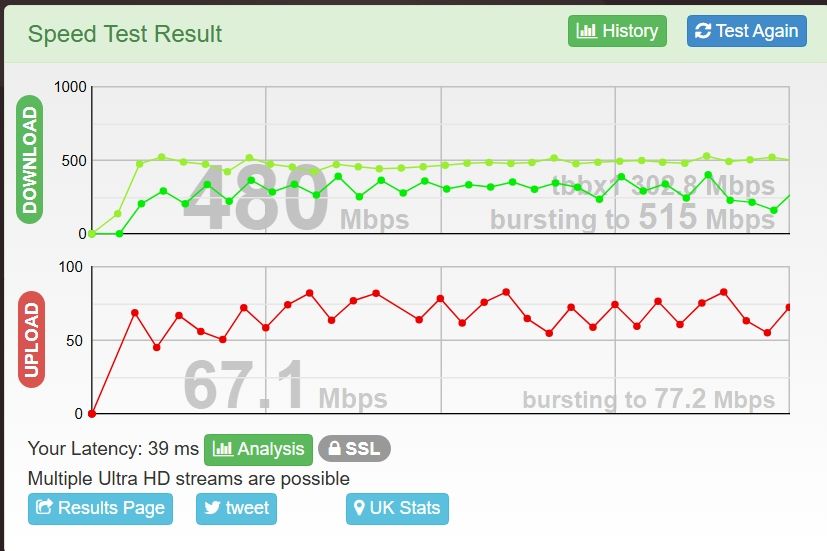

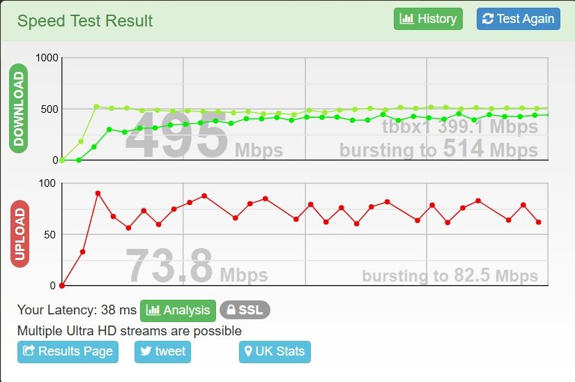

@Battius Have a picture the other day on a posting speed related but just easier to do it again, wireless wi-fi connected on a FF500 and thinkbroadband also, will let you compare against yours! Pictures take a little time to be cleared for viewing!
On 11/10/25 at 11.33pm as an OP was complaining speed was way down.
This on was 1/9/25 at 3.20pm as another compare for you!

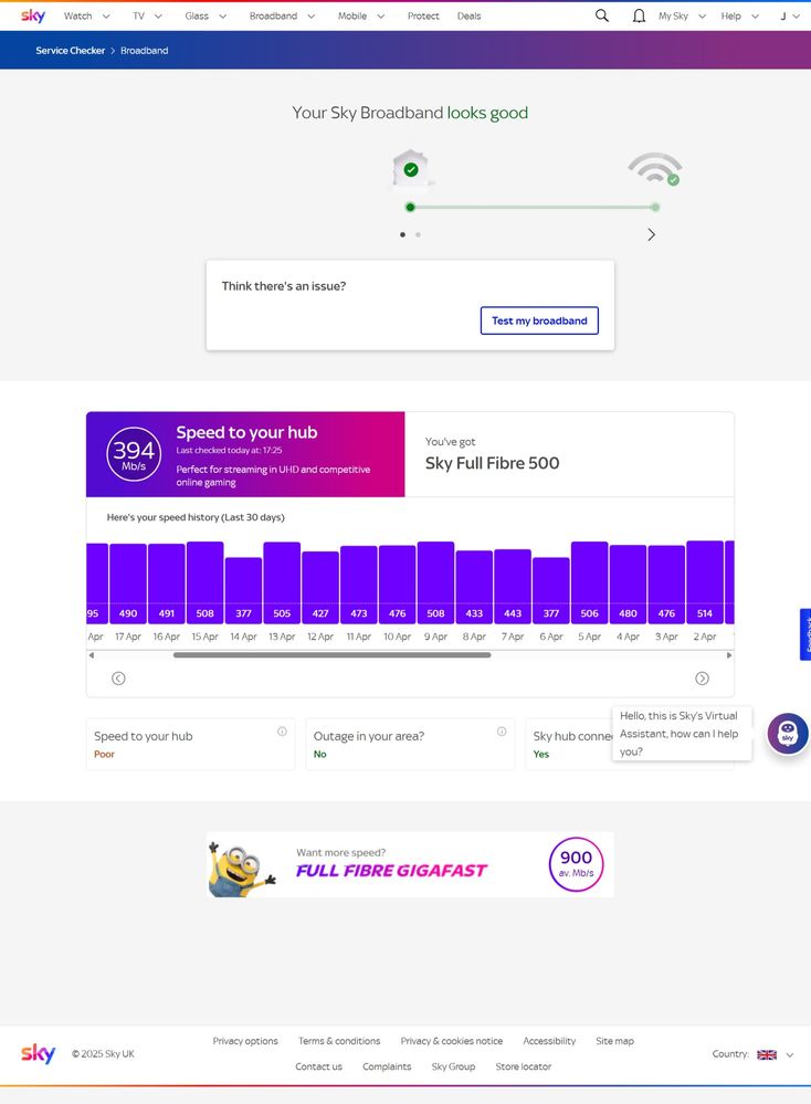

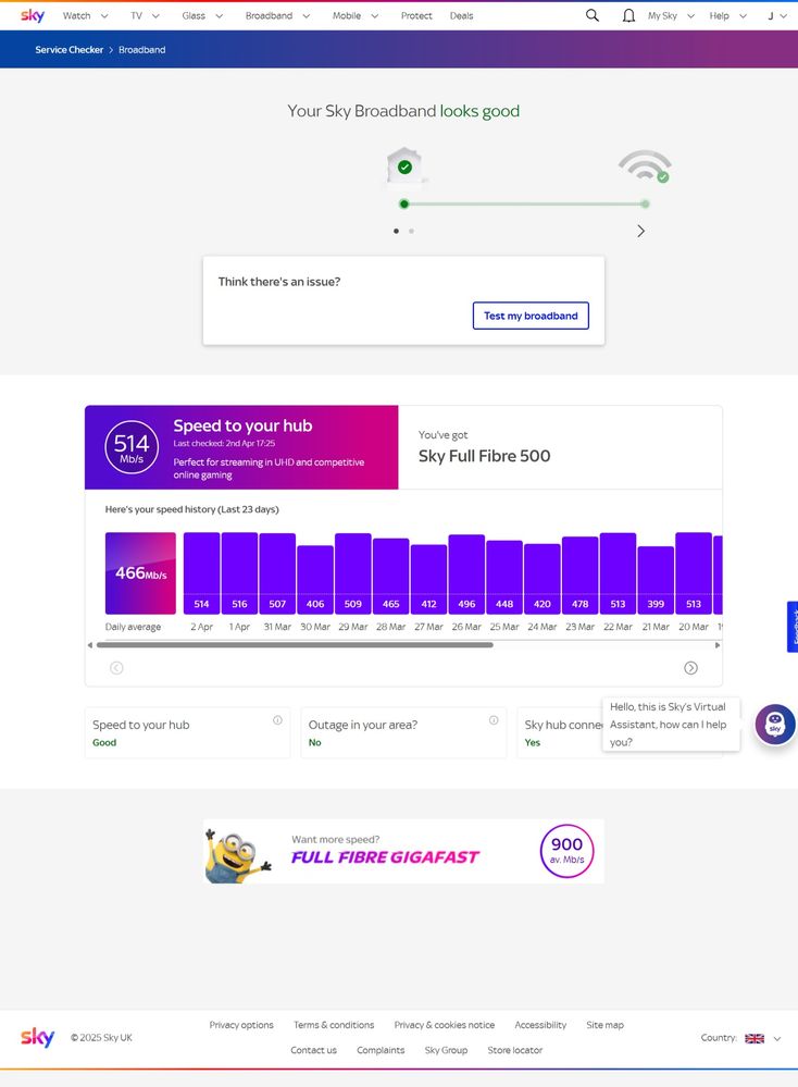

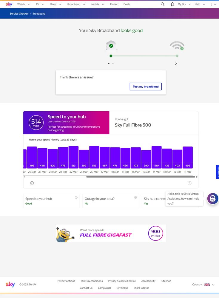

@Battius Although i no longer have my old SR203 connected this was what it was like on the service checker for speed/time!
Picture 1...
Picture 2...
Picture 3 and all back on Mar/Apr 2025 time scale....
