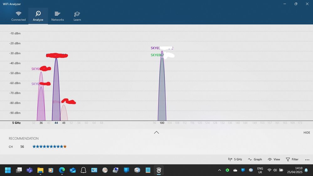

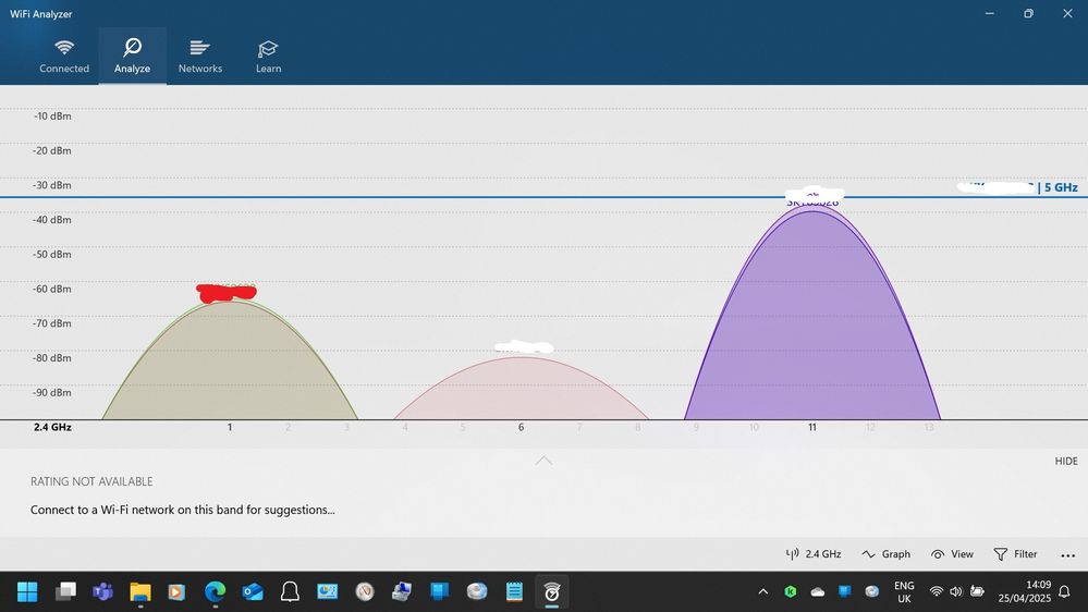

@andy0306 You are correct about a good/stable wireless wi-fi signal and also about the signals around etc, would be more concerend about your with/without test's and no improved performance with the extender, is your laptop a windows device, the dropping to 2.4Ghz band which is a more powerfull signal from the router and does get about easier through the home, can be a laptop issue as the device does go to what it can see as the best signal, some times adjustment to the properties for the laptop wireless nic card can take care of it, Device manager is the place to look, and Roaming Aggressiveness etc but look see and adjust slowly.
You are certainly on the right track. Edit:- couple off pictures attched as to how and this is all mine apart from the BT popping in with multiple transmitting devices that i have, gives you the idea. Just give the pics time to appear and be approved.
2.4Ghz band
5Ghz band

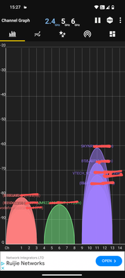

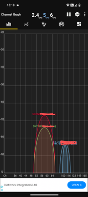

I didn't think an extender improved speed, it's just there to cover a greater area. In fact I thought it actually lowered the speed due to being routed through it.
My area is as below, which as you can see is good for the 5g coverage.
2.4 is a little busier due to is longer range I guess.
