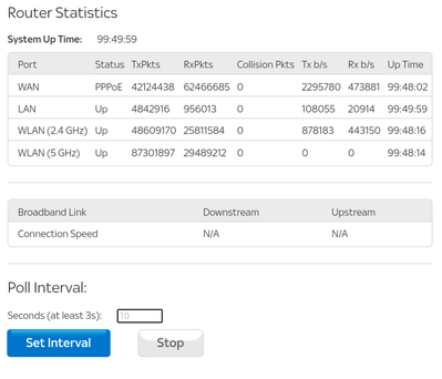

For a number of months my wifi signal has dropping early every morning, around 2am, and coming back 10+ minutes later. I know this is the case as my Nest Doorbell reports, via a notification, that it is no longer connected to the internet. Initially i thought the problem might be the doorbell, but recently an ev charger was installed at the property and that system reports similar issues, so its definitely the wifi.
The router is set up to transmit both 2.4GHz (needed for the doorbell and ev charger) and 5GHz. The router Statistics say that the System Up Time is 99+ hours but the WiFi does drop every morning, or at least the 2.4Ghz signal does, and i have logs from the ev charger to show this. Any suggestions as to what might be the cause and potential solutions?

Thanks @jamesn123 . I think this may have done the job, cheers
