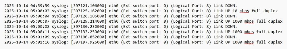

This now brings me to the current issue, which to my knowledge is not affecting me. But said network engineer showed me there were issues on the router albeit early hours of the morning and suggested contacting Sky. Could someone explain the meaning of the following attachement please - is there an issue or is this typical of how the Sky Router works?

@Fromby_1907 Logical Port 8 is the physical Port 1 on the back off the sky hub, so the device that you have connected whatever that is, is either disconnecting, losing power or doing something that is causing it to reset it's self and the sky Hub is seeing that.
Whatever you have connected on port 1 is what you need to look at!
Not sure what the sky Q and the mini times are but Eco mode operation would be sure fire to look at, sometimes called standby mode, drops to low power and may just mess with Ethernet connection!

Thank you for the swift response. the device was the NAS and the internet cable wasn't fully home. The only strange bit was why 5am ish? Not expecting an answer to that but releived its nothing to my initial coneectivity issues - which for the moment have not returned, 6 days and counting...

@Fromby_1907 You can take a look again at the log tomorrow and see what is happening, and as you say why 5am is a question you may know, auto backup running around that time etc... Normally seen when ports are connecting / disconnecting so if you pull the cable out will record off, and when you push it back in it will say on and connected again. Log is not that big with auto write over 24hrs is about the norm that can be seen with the general logging that goes on! But you are well aware as at least you know how to get to it and check!👍
