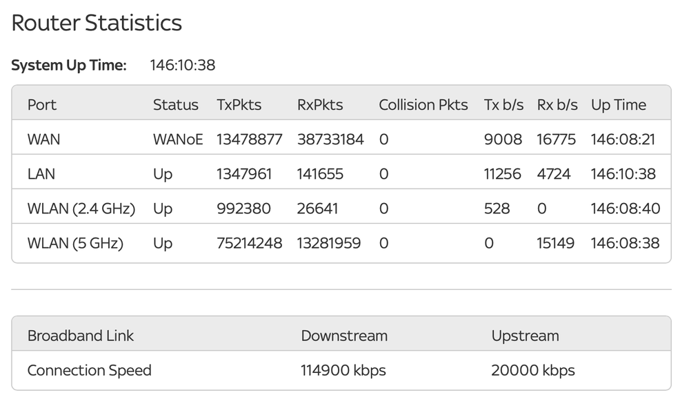

Hello, please would somebody help.
I don't understand on the shenanigans that goes on. I have a Sky Broadband Hub, I'm having trouble with upload speeds. The speed test I just did said 10mbps, but it feels much slower. Struggling to do anything, even upload the screen shots of my router stats etc. Please help. Thankyou

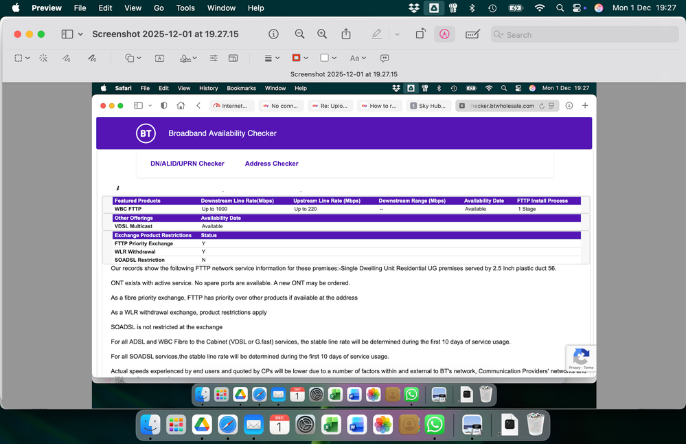

Message posted on 02 Dec 2025 03:39 PM
Re: Upload speed suddenly very slow
Yes that's right I'm on Full fibre.
I'm supposed to get 20mbps for upload. But I don't know where I'm looking on stats to check.
what should I look at? Do I get an average on these stats or lowest/highest somewhere.
speed tester showed 10mbps yesterday when I tested.
thabkyou!
Message posted on 02 Dec 2025 03:52 PM
@Genie99 There is NO such thing as supposed to get for upload, 10Mb/s was not bad on your 20Mb/s sync speed, and you will never get the same speed test twice in a row...
