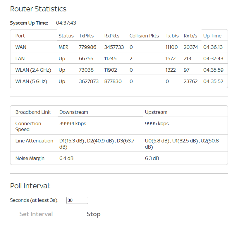

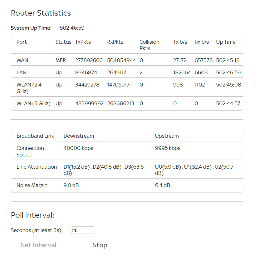

Re: Unstable connection
@Jase31 Old stat's screen while on the 40/10 fttc split when issue Noise Db was always around the 6.0 mark, but lets you see is about 18 months ago before i went Fibre. You will be able to see once the picture get's approved for viewing!
Old SR203 stat's screen for ReferenceOld SR203 stat's screen for Reference

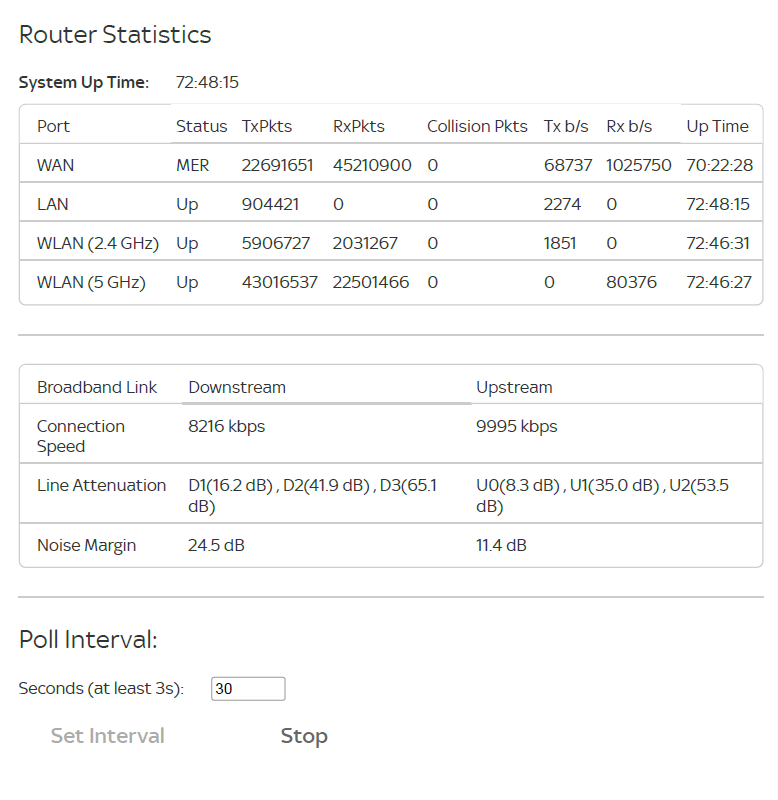

@Jase31 Took a bit off finding but new i had kept so both are from 2021, Stats1 kind off the norm, and Stats2 in the toilet Noisy line! As before will clear once approved for viewing.👍
Stats1 normal operationStats1 normal operationStats2 very noisy line killed speed and stability!Stats2 very noisy line killed speed and stability!

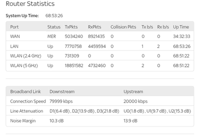

That's a huge difference Jim! here's a recent one of mine which shows it's still a bit high but he told me to wait for 10 days so I'll post a newer one in 10 days.
 I was told also the upstream being noisy doesn't matter that much Jim. No idea if it's true.
@Jase31 Will check it out when cleared for viewing! Don't let the engineer fool you, UP though not as important as the down if problems on the up compounds the down, it's always a two way street!
Seen now, certainly way better, keep an eye on that WAN time that will indicate drop's everytime it does a wan will peg back to zero and go again, but would say you probably will be seeing speed fine and stability a lot better!
