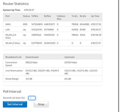

Hi @Rich+in+name+not+in+balance Please post your router stats
https://helpforum.sky.com/t5/Broadband/How-to-find-your-Sky-Broadband-router-stats/td-p/2855717/jump...

Thanks @jamesn123 @I've posted here now.
Re: Unstable WiFi causing issues with battery operated items.
Your stats dont suggest an issue with the WiFi radios on your hub so its quite possible you need a booster to cover the area your ring devices are in

Thanks @jamesn123 - there's already a booster being used. The bigger issues we're finding is the almost "death" in Wales when there's more than 1 person working at home!
