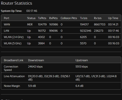

In July 2024 I switched from Vodafone fiber to SKY only because of the lower price, previously I had no problems with the connection speed, after changing to SKY I did not pay special attention to the maximum connection speed, but in December I noticed that the maximum transfer of downloading files was only 2.8 Mbytes/s, previously in Vodafone I had at least twice as much. The IT specialist (I work remotely) checked in the router that VDSL is connected at 25 Mbit/s although I pay for the Sky Broadband Superfast connection. Is this a basis for changing the provider without incurring the costs of early termination of the contract. The issue of the slower connection that I have is becoming more and more frustrating for me. Thank you

If you have a black hub could you post your ststistics
https://helpforum.sky.com/t5/Broadband-Talk/How-to-read-your-Sky-Hub-statistics/ba-p/3645346

Message posted on 24 Mar 2025 02:40 PM
Re: Superfast Fiber and VDSL connection only 25Mbit/s
From my router and Connection from your website
Message posted on 24 Mar 2025 02:41 PM
Your stats show a slightly raised noise margin but not enough to make a significant increase in speed
The other link will show what openreach say you should get

What was the speed Sky quoted you when you signed up? it should be in your welcome email.
Looking at your router stats they look a bit slow for your line length but not awful.
Ok so it looks like the line is quite bad. But sky are unlikely to task openreach to fix when full fibre fttp is available
