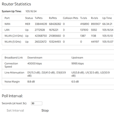

For your info and some copied details,
I reset the router yesterday to get new start, copied captures just before
the 20hr mark, and then later for Rx b/s values, i will get the Tx b/s but it is always
in my experience that it is well later, will check at 24hrs, 48hrs etc. don't think that it
is quirk just off my hub, experience shows with FW upgrades you just get to know what
to or what not to expect and ignore all the things that you wish did not happen.

Message posted on 04 Jan 2024 06:31 AM
Re: Stat's SR203 Quirks
I had to leave and get sky telephone fix so missed a couple of days monitoring
You will see now that the Tx and Rx have now gone zero and will stay that way until hub is reset, update etc, so may be quirk of my hub but don't think so. Somewhere between times and never sure when it happens so just put it down to one of the many quirks.

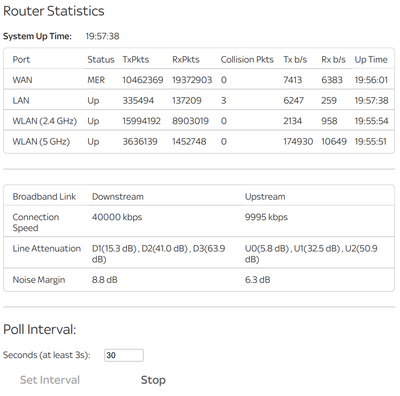

Message posted on 04 Jan 2024 09:07 AM
I was connected to the router with my laptop wireless on the 5G band which it always is,
I think on picture 2 you will see the TX stopped about that time, it never goes again. Then on the
final picture you will see that the RX stopped, the packet's keep going so that indicates that the 5G is working, Times varies i think, first one is always fairly quick, second always longer. I have no complaint
it's just a quirk of the router, like devices not showing up when i know they are connected.
Not sure which FW screwed it all up, and i have had this router about 4 years i would say.
Lets you know, that when the stat's are posted you cannot trust when you see 0 b/s on any of those fields.
Due to me going away for couple days obviously could not get the precise time, was checking every 24hrs....
Jim
Message posted on 04 Jan 2024 09:09 AM
And i was snapping at 30sec, so i could print to pdf to capture, always turn it back to 10 when finished.
Just not quick enough to do it all in the 10sec time....
