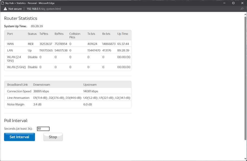

I've been a sky customer for sometime, my guarenteed download speed is around 54Mb/s but I've been constantly getting around 35-39Mb/s.
I suspect openreach are to blame, is there anything I can do?

Openreach engineer came out, said line from exchange, cabinate, and distribution all look good. We did find a sneaky tap in the house which he removed, and cleared the error it was causing on the line.
Connection is still sitting around 36Mbps. My assumption is it will take a couple of days for the the line to start picking up speed. Is there anything else I can do?

Your downstream speed is still way too low for what it should be on a line with that attenuation. You will likely need another engineer visit to have it looked at
