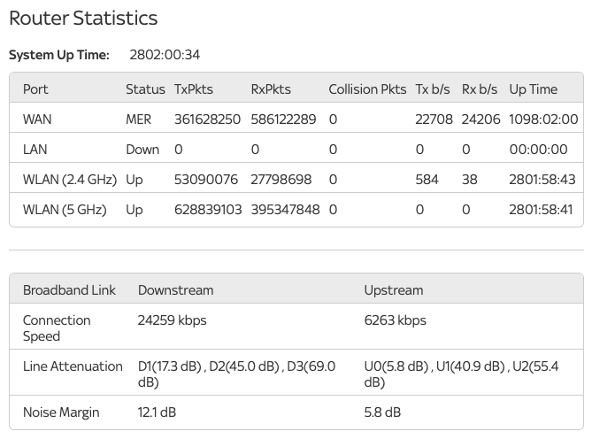

I am on Sky Broabnand 35, which sugests speeds of between 32MB and 37MB at my address and guarantees at least 30MB. But for quite some time I've been getting in the region of 20MB (today 21.8MB).

@ChrisEJ1993 given Sky have given you the option to leave it looks likeky Openreach have refused to do work on your long line to enable it to offer the speed range the checker says itvshould support and the stats indicate. At some point they will change the database but if you order from another ISP now they will base their speed guarantee on the database but you are going to go through the same rigmarole as you have with Sky as in practice the line will deliver the speed you get now.
If mobile signal is poor the only other solution I can think of is Starlink which uses satellites but is quite expensive. This issue will only be really solved when full fibre is run to your property that could be years away.
