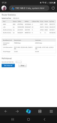

Please post your router stats
Message posted on 29 Feb 2024 05:32 PM
Re: Sky Router wifi drop out! 3rd party way forward???
Message posted on 29 Feb 2024 05:34 PM
Your router is showing a stable connection so I suspect the cause of the problem is your Sky Q. How many Sky Q mini boxes & boosters do you have if any?
