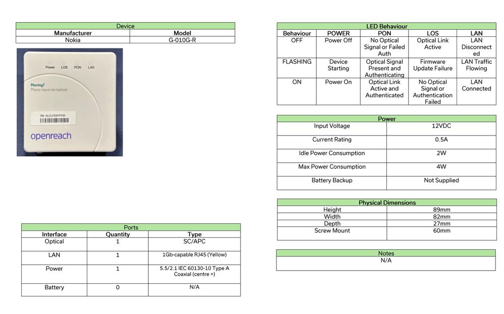

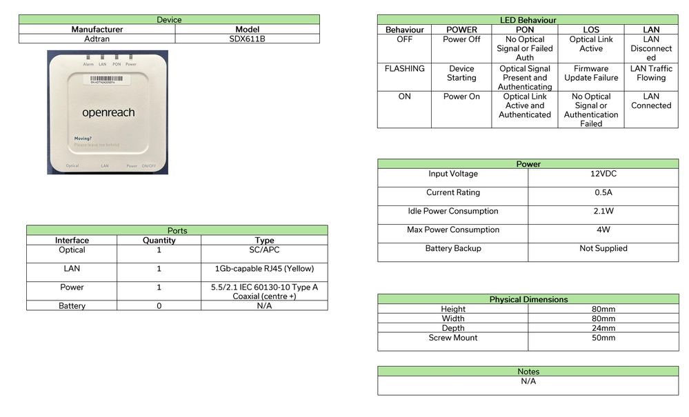

I've had my Sky Max Hub for 10 months and there's been no issues, but today after coming back from university, the Sky Hub has suddenly got a red light and my wifi isn't working at all. The 'PON' on my Openreach box isn't flashing with any light, although there's no light on the 'LOS' either.

@iamash9 The ONT Modem Power and Pon need to be both SOLID Green light, lan can flicker on it as data is sent back forth to the Hub, if you do not have that condition then your Internet will be down!

The PON is not solid green, there's no colour on it at all. What needs to be done in this case to get the internet back up and running?

@iamash9 Give us a hint, you do not say if you have ever seen the Pon light anything else but not lit!
Adtran
Nokia
