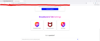

I can see Advanced Settings under https://www.sky.com/myaccount/bb-and-talk, but when I click on it it only gives me WiFi Security Level and that throws an error.

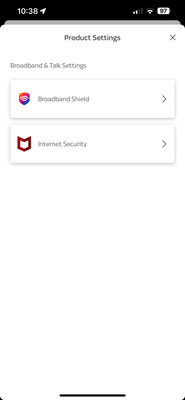

I appear to have having the exact some issue as OP. Whenever i try to change any of my settings in sky.com I'm presented with the same errors.

@Aarong8 you have to use the My Sky app to change the settings on the Max hub you cant do thst from the website.

Yes I did try to edit the settings in the app, but I also don't have access to them there. I only have access to broadband shield and internet security in the app for some strange reason.
Been trying to portforward so has been a bit of a nightmare

@Aarong8 if after signing out of the app, closing it fully then re-opening it and digning back in you cant see the setting call Sky as they need to get the control added. Seemscto happen rzndomly thst some accounts are missed.
