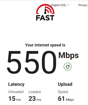

Thanks again for your input... I had a second OR engineer come out this morning and she confirmed the set up was good from their end now. She was going to formally close the job and hand back to sky. My speed tests just now were as follows...
Thanks again,

Message posted on 02 May 2025 09:34 AM - last edited: 02 May 2025 09:36 AM
Re: Sky Full Fibre Installation - Not working
@PaulH74 Once the picture is cleared for viewing i will take a look see for you. Also take a look at the sky link below regarding speed.

Message posted on 02 May 2025 10:41 AM
@PaulH74 From the test i would say just looking at what you have posted, and it is not complete, so next time hit the update button more info will pop up bottom off the screen give you the download to your device, but looks like you have FF500 from sky, if correct then you are up there with the fibre to your Hub....
