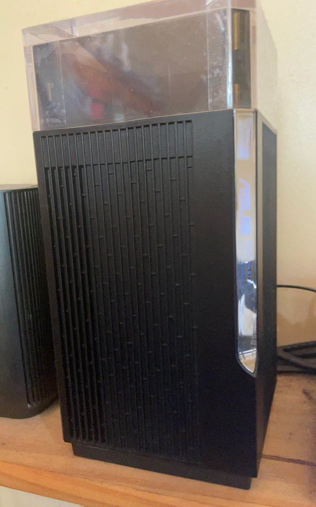

This message was authored by: mae-3
Re: Router recommendation for sky q + mini
@Rchaggar  here is my unit on a shelf...
