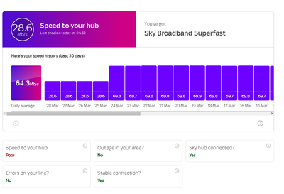

Recently my 18 month contract with sky was up and it has gone on to a rolling monthly contract, Sky was happy enough to bang up the Price to £36 per month but reduced the services, Upon testing my broadband speeds they state that my line can no longer produce the speeds i'm paying for unless i upgrade my services. What makes Sky think that by cutting anyones speeds / services in order to force them in to re-newing their packages will work ? I will either not be paying what they're looking for due to getting half a service or cancelling, Obviously a very untrustworth ISP.

I have also run their diagnostics which says for the last 4  days i have been getting 27mb, which is  when i hit the rolling contract. Had next to no issues until now. So i run their test and done everything it directed, says i'm back up and running, no change to speeds etc.

Your stats suggest you are still getting 77mbps. Have you actually run a speedtest via ethernet?

Looks like your line has been capped at half rate.
This has been seen a number of times by others where the connection rate to the modem is at or near full rate (like yours at 77Mb/s) but the throughput is capped.
What is your minimum downstream rate from your contract?
If greater that 27Mb/s then you can open a complaint with Sky.

Maximum speeds 79mb, Guarenteed download Speeds 58.2mb and upload speed is 19mb. I have spoken to Sky on the phone and i was made out to be an idiot, so i thought i'd come to the forums help and information to help me along the way with the complaints. I really appreciate the information you guys have given me.

The key evidence you have is the speed graph you have posted.
This is the actual download speed rather than the connection speed.
If you believe you have exhausted your discussions with customer service, then open a formal complaint with Sky (there is a web form for that) and attach their graph.
State that you want the situation resolving in a reasonable time frame (within 2 weeks).
