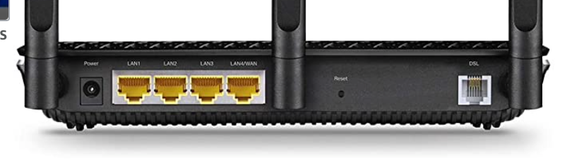

I m sorry to bother you but do you think that
TP-LINK Archer VR2100 WiFi Modem Router - AC 2100, Dual-band will work for me ? As modem and router in one box ? So I will have only one box for all.
Message posted on 19 May 2021 09:08 AM - last edited: 19 May 2021 09:13 AM
Re: Replacing Sky Q Modem Router Suggestions??
Yes, you need to be searching the internet for a 'VDSL2 wireless router'. [add] correct yes that one is okay on Amazon, just ensure it has an RJ11 socket on it which is like the one on the right which is white below.
