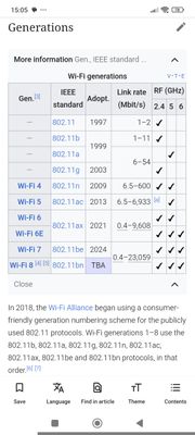

That appears to be 802.11b/g/n ('WiFi 4') hardware, so a long way off the current WiFi standards.

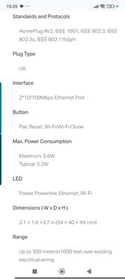

@TimmyBGood Good to the 100Mb/s speed, that;s as good as the Ethernet port get's!
Edit:- @Ph03nix You have that wrong, the nic ports are 100Mb/s max!
Will go test the garage one for you, that's the furthest away cable wise!
Ookla is 40/15 Mbps on the FF500, and netspot was 59.59Mb/s download it does not do an upload in it's test, garage is 25Metre away from home and reciever is up stairs on the circuit! The AV1000 is at the Ethernet switch simple reason the original AV600 packed in after 6 years on the power and you cannot get the AV600 as a new model Tp has obsoleted them replaced abou 3 months ago so the AV1000 will be running in AV600 mode even though it has a Gigabit nic on it! Use both types now so have a spare AV1000, would not buy 2nd hand as you have NO history off use, just look at mine been on that length off time never switched off!

It's an outdated specification overall, which probably relates to the price-point. As @JimM1 indicates, the ethernet is 100baseT rather than gigabit.
Realistically all Powerline hardware is now rather overshadowed by modern mesh WiFi.
