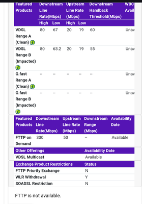

No real idea but I'm pretty sure cabinet is at end of my road. Did the BT availability checker and got the following which looks to be the speeds I had previously. But I'm not really sure about what's what there.
