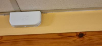

Have they already installed a small fibre drop box above your door

I also have a quetion re this. I have im told the fastest Sky BB available to me, the small block of flats where I live has recently been wired for Full Fibre, the work was completed on 18th September. One engineer said give it a couple of weeks to be checked and signed  off then you can apply to have it through your provider.
well its now today 27 days since the work was completed, and each flat has the little box above the flat door ready to be connected to this ONT (what ever that is)

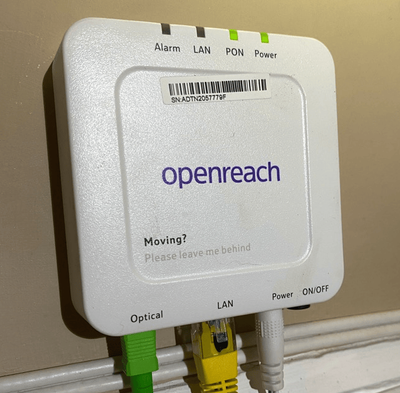

@padre
An Optical Network Terminal is the powered box which goes inside each property for connection to fibre on one side and an ISP router over ethernet cable on the other: it's effectively a 'modem' because it's handling a change in signalling (light to electric)
