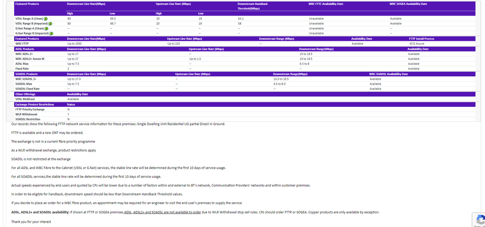

Re: ONT location without wall power socket
@TimmyBGood thanks, here is a screenshot of the availability checker results.
@hgwv
The key information is 'UG partial Direct in Ground'
That means the existing copper cable is directly buried and so digging (and probably a new duct) will be required to lay an optical bearer.
This often leads to delays beyond the initially promised activation date, or a long lead time.
