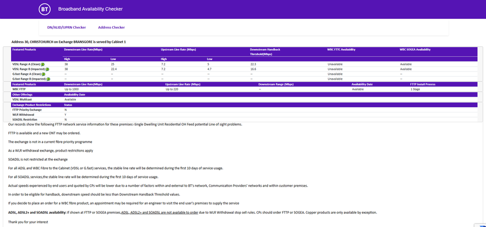

It is an overhead feed with possible line of sight issues. So fttp exists but may be trees in the way

Unfortunately that doesn't help if the local optical cable distribution is overhead.
Perhaps try a few neighbouring addresses in the BT Wholesale lookup to confirm.

All we can go by is the lookup results, which as @cookiemonsteruk said indicates a (problematic) overhead connection.
If there aren't underground Connectorised Block Terminals (CBTs) in the vicinity then ducting cannot be used because the fibre just isn't there.

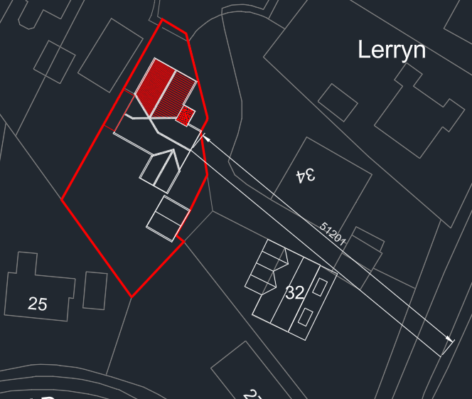

Assuming Openreach take the fibre cable the 51m, accross the road, then across my neighbours garden, across our shared drive way to my house. - how will they do that ?
would they need access to my neighbours garden ? if I was him I would say no.
Just cant see how they are going to do it, and ofcourse cabt speak to Opereach to find out !

As the national network maintainer Openreach has some (limited) statutory powers, but still has to seek wayleave to fly cable over private land, and gain permission to access while working.

That was my question. how is this done ?
Im guessing the cable would have to be physically walked through the neighbours land.
Therefore I am held to ransom by whether or not my neighbour agrees.
